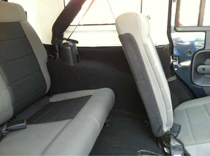

Teraflex makes a bracket to run a (2dr rear) jk seat in the cargo area. Really stout bracket that even lets u flip the seat up and Down as it was designed.
View from passenger rear door
