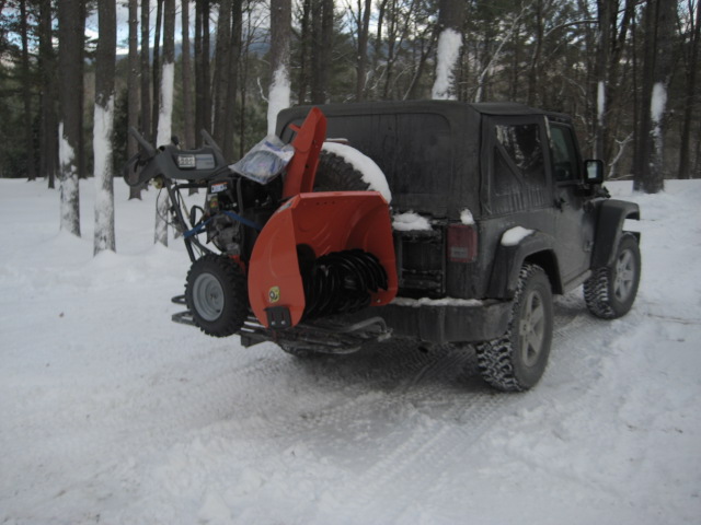

two different sets of wheels rubicon and mb15
btw it was after I had had them put snow blower on the rack I noticed my first death wobble when snow blower was off its only 200lbs but nothing seems damaged in rear ? track bar or what ever but never had a tremor before the blower was on then next day I had drath wobble out on highway over first bump I hit . the front track bar is now new and no death wobble anymore
