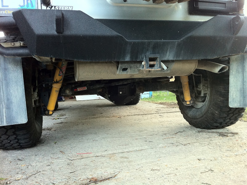

I use a Rancho front diif skid and a AEV Nth Degree rear diff skid on my stock height 2008 Rubicon. I'm going to put them on my 2012 Rubicon along with Riddler Diff covers, Rock Hard skid plates, & lower control arms skids. I really used them on rocky Az trails but they held up really well.
Photo of the Rancho front diff skid from the front after use, just scratches (I powder coated the skid black over the stock red)
http://i203.photobucket.com/albums/a...s/IMG_0151.jpg
Photo of the AEV Nth Degree rear diff skid from the rear after use:
http://i203.photobucket.com/albums/a...s/IMG_0141.jpg
All my skid plate photos Photos:
Rock Hard Skid Plates pictures by azsandrider - Photobucket

Jesus, hump rocks much? I want that rancho front skid real bad now, thanks for the pics!

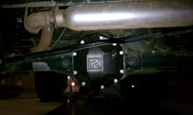

I stayed away from the skids because you 'could' still rip it off, possibly stripping the bolts. My Riddler covers are smooth and protect the bolts. Just my $.02

yea, my pics was right after install, a month ago, they have taken some pretty good hits already
Attachment 363170
My thoughts exactly
I even got a little creative with the paint on my Riddler Cover
As for the front the Dynatrac cover on my PR44 is more than up to the Job, I really like the dual rib on the bottom to protect the lowest bolt too.
