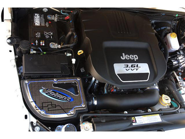

Old Nov 27, 2014 | 07:47 AM
Sierra141's Avatar
Posts: 321
From: El paso, texas
No hydrolock nor hot air in mine, if you like it get it!
