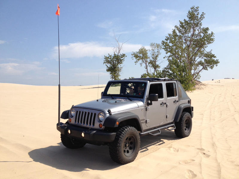

From the research I have done on here it seems the consensus is anything over a 2.5-3in lift and you have to also start replacing steering components, driveshafts etc. starts to get very expensive. I have a 2.5 AEV lift and 33" BFG mud terrains and I am very happy. Of course I will probably opt for 35's when this is no longer my DD in a couple of years. Good luck with your research, this forum is a great resource and the members are very helpful
