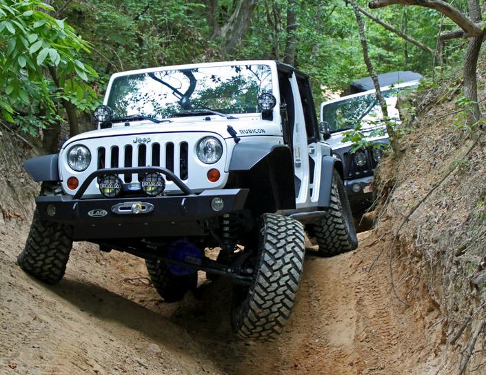

I will offer the other side of this arguement. I am running the Ft lift you mention plus an adj front and rear trackbar and tf front lcas. I have flat fenders and a trimmed pinch seam. I run the nitto trail graps, 37". I also have the stock drive shafts. I am very happy with my set up and have wheeled half a dozem times. Are the lcas nevessary, no, but i think they help the handling. Will the ds fail? Eventually, but i have over 18k miles with no issues. I know everybody loves rk and it seems to be great stuff. I would put my slightly modified ft lift against any standard short arm coil lift out there. This is the first lift ive had that rode like stock and did not sag under bumper/winch weight. Just my $0.02.
Old Aug 24, 2012 | 04:44 AM
mattgt5's Avatar
Posts: 4,406
From: Gray, GA
Heres a little picture of that set up in flex

mattgt5 ... Thank you for the great info, exactly what I want to know. How well are the Nitto trails holding up for wear?
Thanks for the info ......
