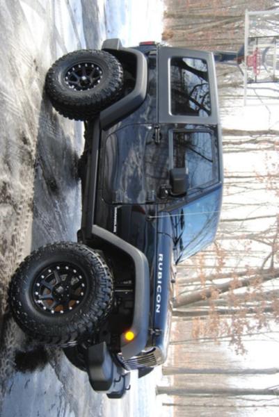

Here is that setup you just described. Besides the body lift. Uploaded from my iPhone so I don't know how the pic will look. But if u look at my past threads I've got more pics.
