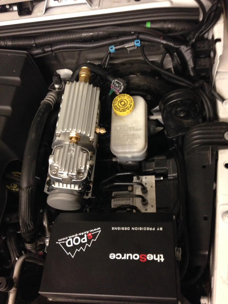

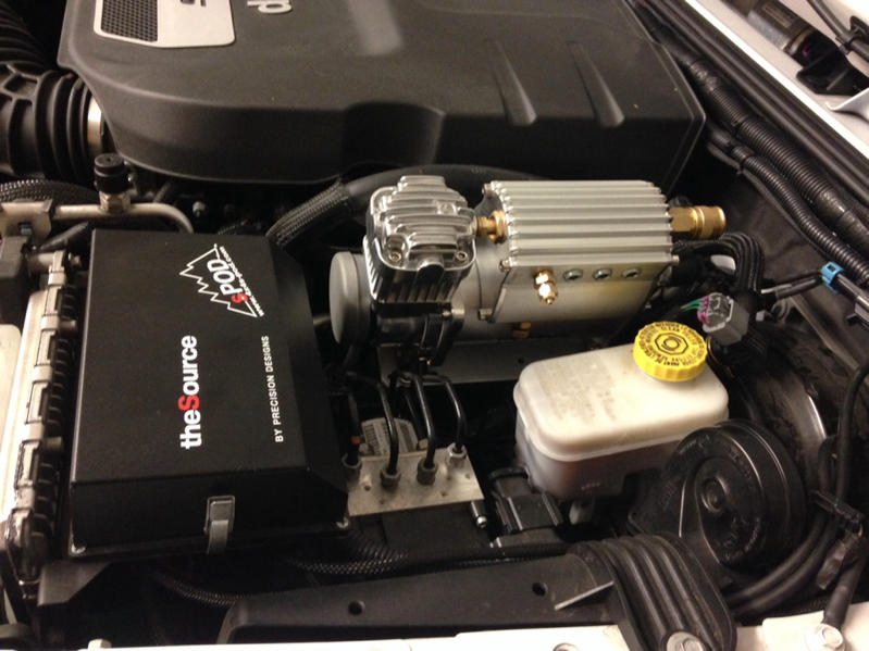

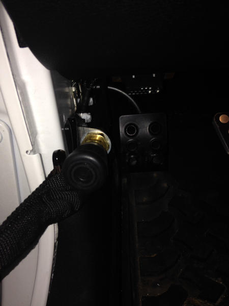

Recently installed the Viair unit under hood with in can air coupler. Clean install and serves my needs well. Price was good.
Attachment 598814
Attachment 598815
That looks like a Viait ADA unit that has a small air reservoir and built in pressure switch to enable hooking up lockers and such. Is that correct? Which unit or package did you buy?

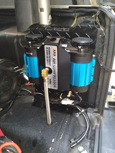

I just bent up some aluminum sheet and mounted the sheet with rubber well nuts to the jeep then used rubber washers between the compressor and sheet. No rattles at all. It's loud due to the high speed and being 2 compressors bolted together, but I knew it was going to be. I have the single under the hood just for my locker so I knew what the sound would be like.
I ran mine down to 2 old scuba tanks I had that I machined down to save weight, mounted where the factory muffler was and plumbed them to the front and rear bumper quick connects.
