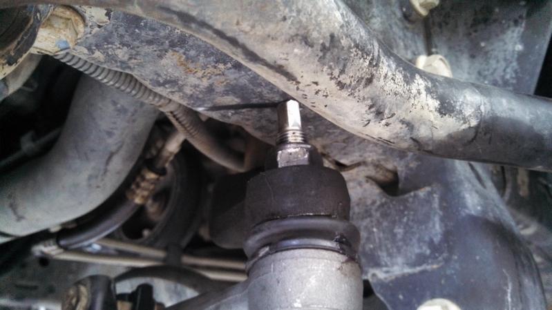

So i went to a local shop and they changed both tie rod ends. only $19.50 labor anyhow i have a squeal sound when I turn sharp and the grease is coming out of the certs I took it to a dirt shoulder and turn the wheel right and left hard .it seems to be getting a little better does this sound right I didn't think it would be squealing.the good thing is the parts are guaranteed for one year.

does it only squeal on a hard left turn??

Hard right turns only.but its getting better though. maybe the grease is working around the joint.

ok. Cause I had my pitman arm tre stud rubbing on the frame on hard left turns. Thought that would maybe be your issue

Nice idea that's what it was.thank you...

ID:	533017(sawzall to the rescue)

Tie rod ends won't squeal. What exactly did you have replaced ? Factory .. Only the pitman TRE (drag link) and driver side TRE (tie rod) are sold separate from the tie rod/drag link.

Ahhh. What joint is that, Moog ?

That is my driver side drag link.

They did both sides of the drag link.
