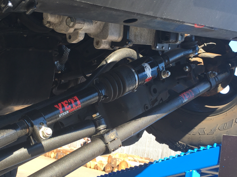

Yeti tie rod last tie rod you will ever buy.
