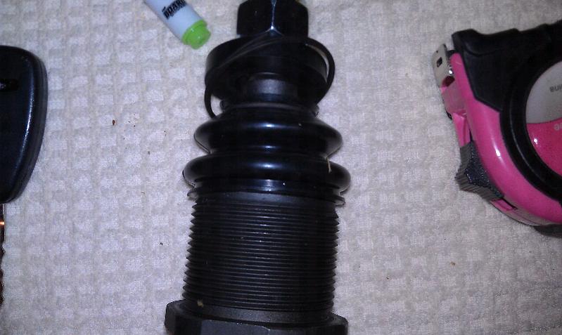

The nice thing about the Currie is it uses cartridges for the ends, and the tie rod and drag link use the same ones.
My Currie is definitely beastly and heavy!

Sorry forgot the pic and the ap won't let me edit it in.

Very nice an look much bigger than stock. Oh yea like the tape measure to. Lol
