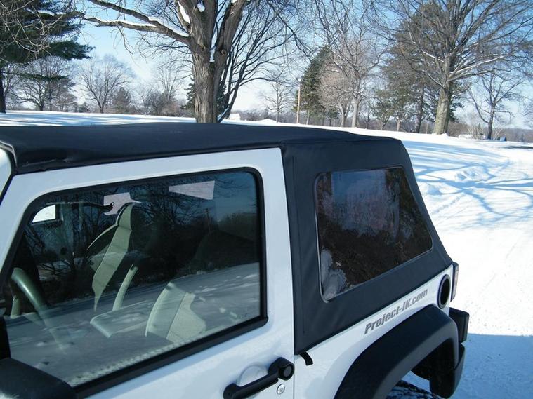

ok so i gave it a shot today. warmed the pieces in the house than then blasted the head throughout the install. surprisingly everything came together relatively easily. though i must say that i think bestop's instructions are the ultimate test of any mans logic. took me a wil to work some stuff out.
my only issue is the top does not want to wral around the doo seals. in the pic below (not mine) i see the top tuck nicely between the doo and the door frame. how can i get mine to stay there?
also there are too small pin sieze holes from which i can see light on the inside. i think ill just epoxy over it though.
