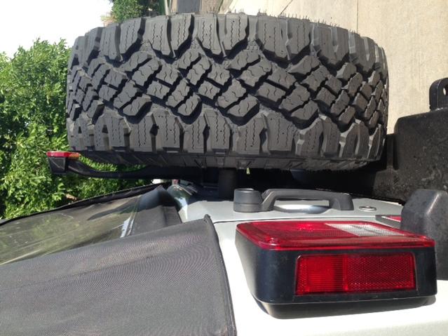

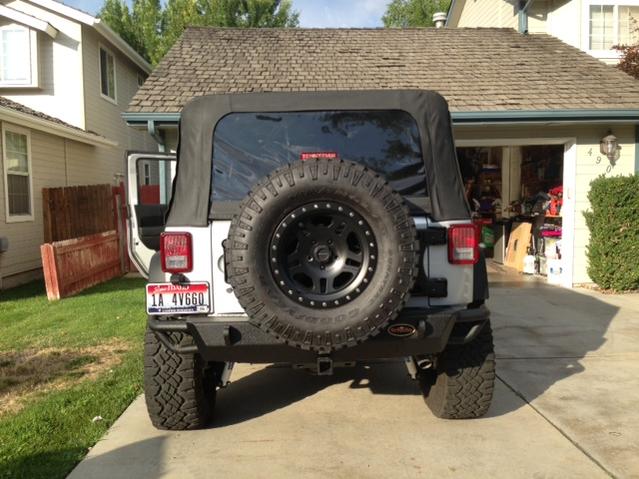

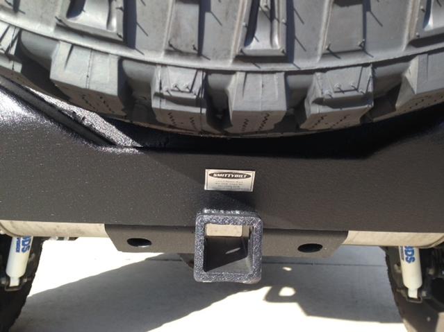

Originally Posted by pingman77
So I just went from 285 terra graps to 315/70/17 duratracs. Im needing advice on carrying the spare. I have the poison spyder rock brawler 2 rear bumper. Can the tire carrier be added? or would I have to purchase together? Would the smittybilt oversized tire carrier do the job. If I had known I would upsize tires, I eould of waited and purchased the poison bumper/carrier combo.
I have the Teraflex hinge with the stock tire carrier and 315/70/17 duratracs and it fits perfectly with my Smittlybilt SCR rear bumper. No movement at all. The third brake light is even visible.
Since the stock carrier is in the same location vertically with or without the Teraflex hinge, I measured from the bottom of the tire to the bottom of the tailgate door. Its exactly 5.75", so that might help if you want to get an idea for bumper clearance.
