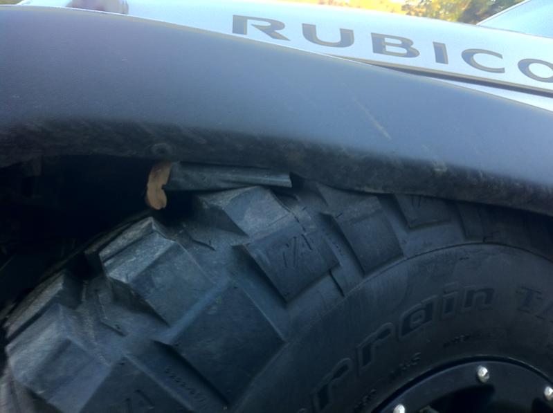

No lift + width wider than stock = rub.

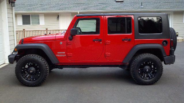

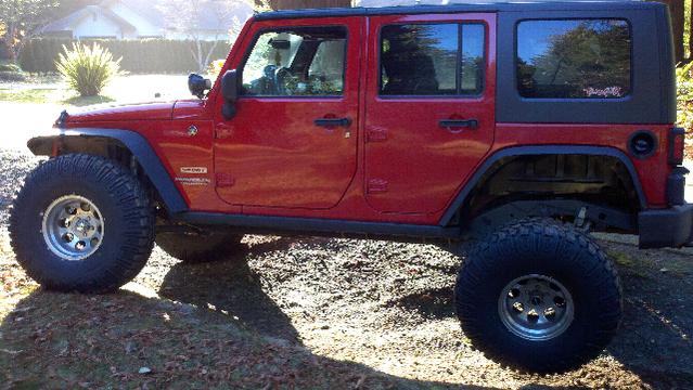

You could go with a leveling kit would be alot cheaper then buying aftermarket fenders unless you cut yours. This is my jeep when I had 33s and a leveling kit.

My photo is with a leveling kit and I tore a piece of plastic off and would have torn my flare off if I turned. Connected, it might not rub.
The width is the issue with a 33" tire.
Flat fenders, increased bumpstops, ot cut flares will prevent the rub.
