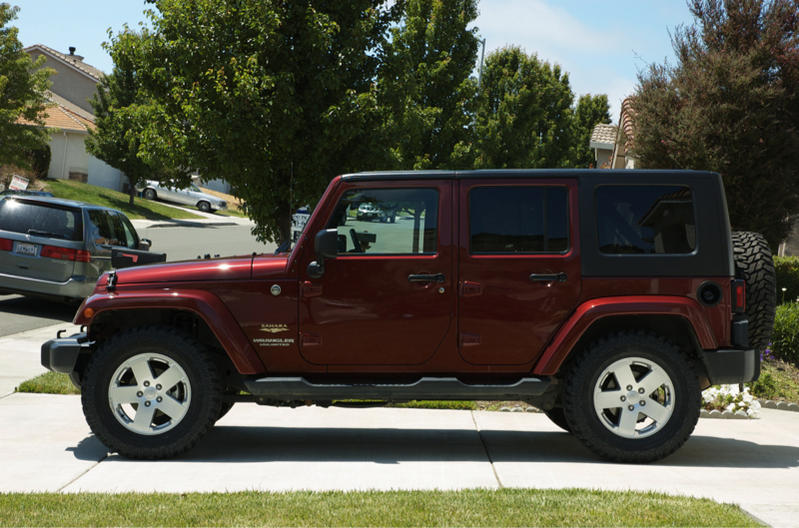

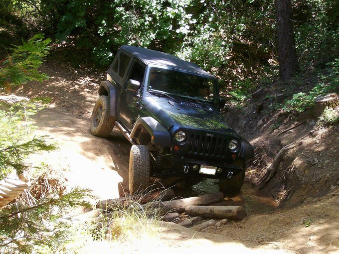

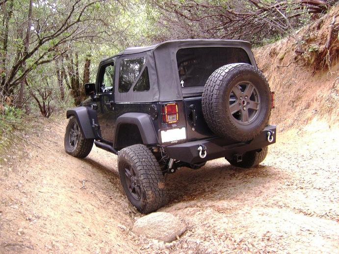

Ran Cooper STTs 275x70 on stock 18s and Spidertrack spacers for 90,000 miles no lift and 2.5 TeraFlex coil lift.

Had to adjust steer stops prior to adding the spacers since they rubbed the lower control arms while turning.
