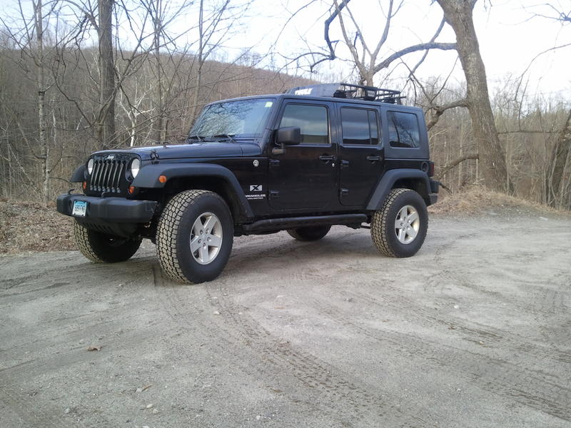

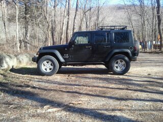

Almost what you are looking for. TeraFlex 1.5 coil lift and 285/75/17 Nitto trail grappler AT.
and do they rub? That's exactly what I'm looking for.
Old Jan 18, 2012 | 05:13 PM
F200's Avatar
Joined: Oct 2008
Posts: 76
From: CT
The fronts just do touch the air dam at full lock. I will need to do a little trimming on the air dam. The backs will get just on the inner fender liners at full stuff, so I need to add an inch or two of bump stop on the rear. Currently have no extra bump stops. BTW, i have TeraFlex 1.25 inch spacers and stock wheels.
are those trail or terra grapplers on your rig? i see you said trail, but checked out Nitto's sight (cause I like them on your rig) and they looked a helluva lot like the terra's pictured...
