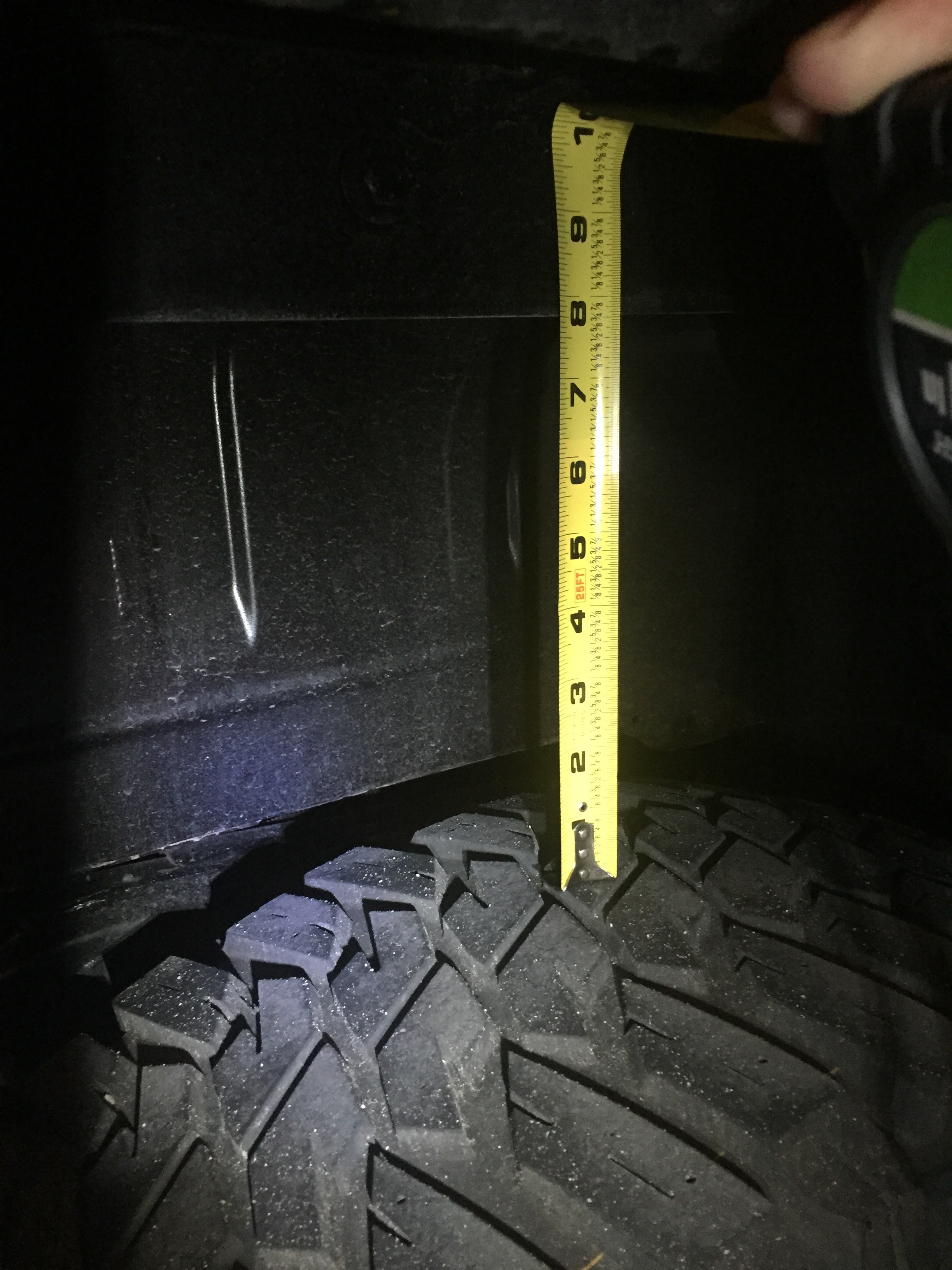

Originally Posted by Jeeptang
I welded in high school and a semester in a tech school. Pretty basic! You need to move here, then I'll hack it up!
Just looked at my wheel well and your right... Dam tub is in the way...... I only have 8" of flex room.... Now I'm sad.. I'm going to have to drink a beer.
