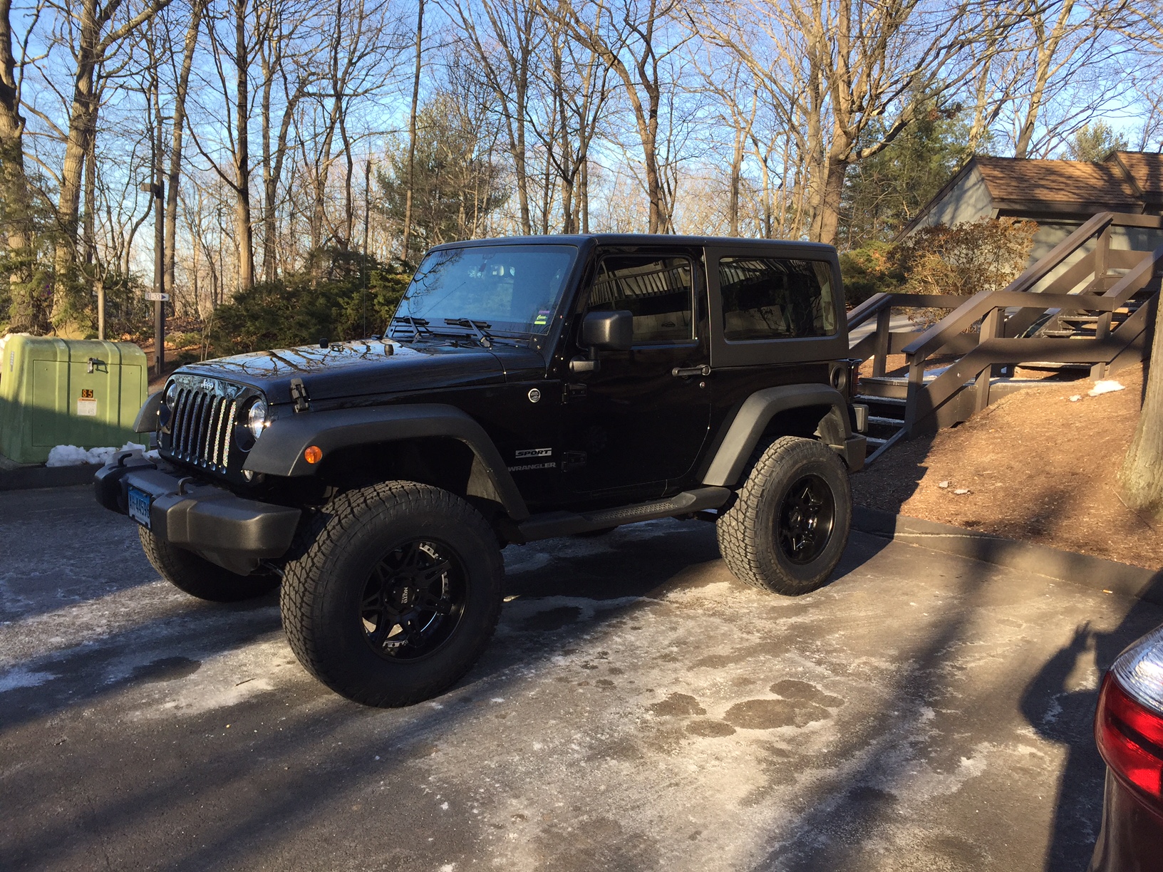

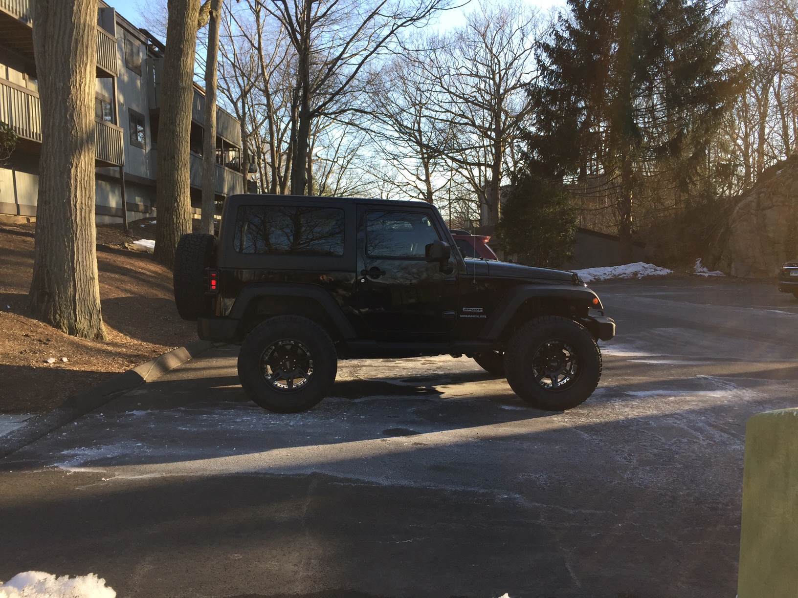

Hey all. I just got my JK lifted, installed gears, and put on some 35x12.5 Nittos. All of the tires are at 35 PSI and the TPS seems to be reading accurately and yet the damn yellow tire symbol wont stop flashing.
First Question: I'm running 35x12.50 Nitto Terras on 18x10" wheels. What would be the best PSI?
Second Question: What can I do to make the JK's computer happy so it will stop that damn yellow wheel symbol?
Thanks
