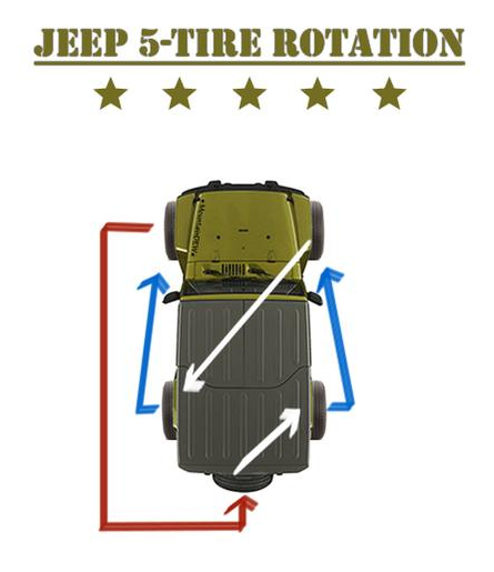

Yes, you can run your tires at any location, the only instance you couldn't would be if you had directional tires. Personal preference when it comes to the rotation pattern. I like the 5-tire rotation to get the spare in the mix. Keeps wear even on all and I paid for 5, so might as well use all 5.
Attachment 343533
Dat's da way uh hu uh hu I like it!
