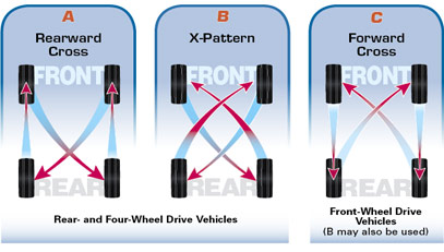

4 tire rotation I'd pick "A".

5 tire rotation I use "G" every 5k when changing oil.
