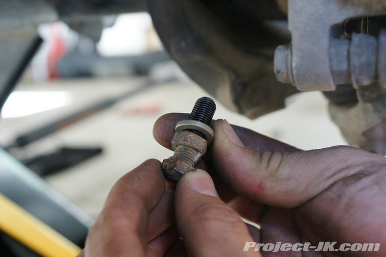

I rub as well. I couldnt find my rub for the life of me. Im running wheel spacers as recommended because I stuck with stock wheel and threw on some Guard Dog 315/70r17's. For weeks I looked and looked, I finally found my rub. The Jeep cranks the front tires so far that I actually rub my front Lower Control Arms. I can get rid of the rub by placing a washer in the steer stop stud. Maybe you are hitting the same thing. Good luck finding it.

The cure is to put a washer behind your steer stop stud. Let me find you a pic.

Use a 3/8 washer..

Good thought just stop the tire that tiny bit before it rubs. I'll look into do that. But I still wanna know where it's rubbing especially sense I researched the heck out of this and was not expecting and rubbing at all with my setup.
