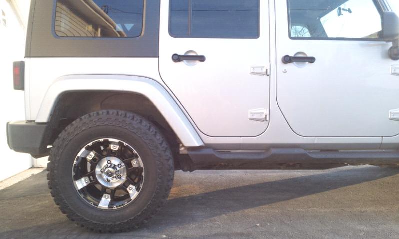

I bought the cooper discovery at/3's w/kevlar about one year ago. Im big on products made in the USA but THE only thing Im kicking myself for is that I got the load range E. Not smart on my part because of how much they weigh. I have to hit the overdrive button when im going up hills with my cruise set. Went to the dunes in Michigan and i let almost all the pressure out of the tires and yet the sidewalls didnt give much. If I had a do over, I would get a lighter tire.

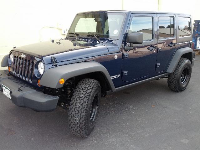

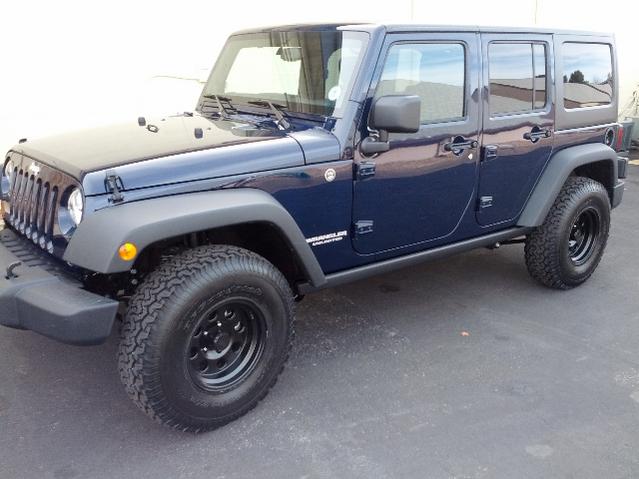

Look at the 33x10.5 BFG AT. Very light and a C rated tire. Just put them on with no lift, but running new wheels with 3.75 backspace.

Now that you have had those tires for awhile, what do you think? I also own a JKU and am really leaning in the 33x10.5x15 AT direction. I have had good luck with the BFG ATs in the past but have never ran this size. This is a relatively common setup on the TJs, but rare on the JK. Seems like a very good solution for highway/snow covered road/sportsman/woodsy trail type application(which is what I do).
Any regrets?
