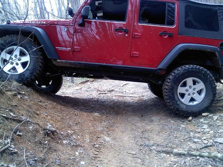

Originally Posted by dave810
thank you for the explanation. Im new to all this. im ordering my tires now.
They will work fine. 315/70/70 is 12 inches wide not 12.5. I run Mickey Thompson MTZ's that size works great. I have 1.25 wheel spacers. I love the factory wheels.
some stores wont mount........... go to another store!!
