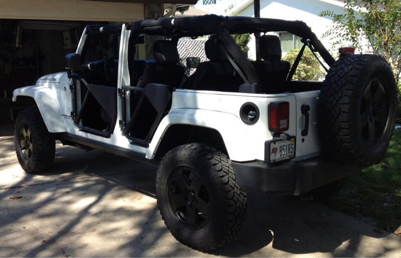

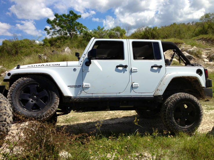

I'm running spidertrax wheel spacers on my factory wheels. I have a 2.5" teraflex lift with 275/70/18 Duratracs.
I run 3.21 gears
I want 35s now.....just like everyone said I would.
