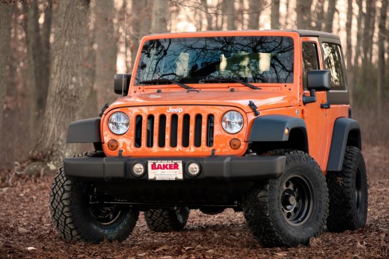

Anyone have a guess as to the size of wheel/tires on this and if it looks like it has a lift or not? I know they are GY Duratracs...

Lol at seeing this pic AGAIN today ^^. You can ask him, he's on this forum as Alanscott1
