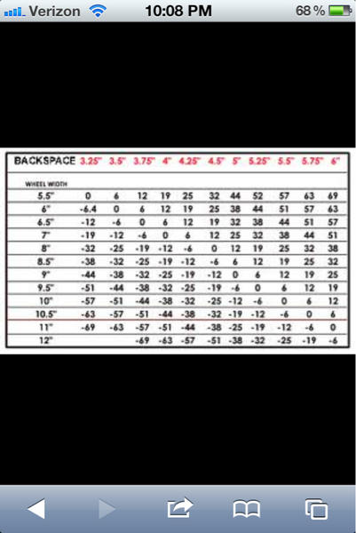

Same set up I am looking at for my Jeep. The -6mm equals 4.5 backspace which seems to be the norm. Should put tire flush with fenders. The stock wheels are 6.
Here is a chart that explains the backspacing.
