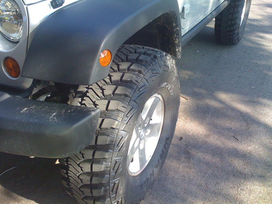

I am running the Goodyear MTR with Kevlar and I love it! Wonderful on the road and even better off. The 37" tires have better road manners than my 285/70/17 Hankook Dynapro MT. I will argue that they are as good on the road as the stock BFG MT's that come on the Rubi...hard to believe...I know...I am certainly amazed too.
I will recommend this tire to anyone!
Only drawback to mine is they cost me about $365 a piece after shipping, mount and balance.
