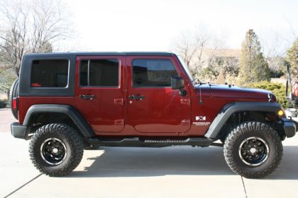

Mine has a 2.5 inch RC lift with 33x12.50x15 great highway driver. Gets 19 mpg's if driven well.

I have been looking at getting the OME HD coils as I have the RE 2" BB with monoshocks and stock coils for my JK....but I am adding a LOD mid-width bumper/warn XD9000i and in the rear LOD rear bumper with tire carrier. Just curious if a 35x12.5R17 will still fit with the addition weight....IE disconnected and full flex with the OME HD coils????

That should work, mine has 33's and still has plenty of room for 35's and I belive the ome coils have a greater lift to them.
