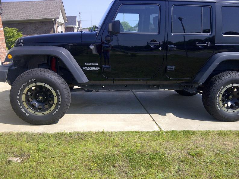

etracy21 Apr 9, 2012 07:27 AM
1 Attachment(s)
I just put these size tires on my 2012 Unlimited Sport. I only have a 2.5" skyjacker lift and I wish I would have went a little bigger. Mine are mounted on a 9" wide wheel so the actual height of the tires is slightly shorter than the height of the tire unmounted.
EDIT: Went and snapped a quick photo of spacing for you
Attachment 301576

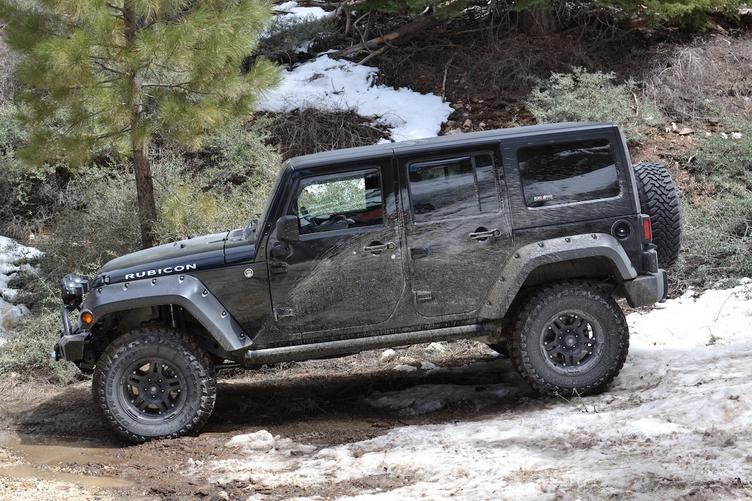

jefemente Apr 9, 2012 07:54 PM
1 Attachment(s)
Toyo M/T 285/75/17 on a RK 2.5 which netted me approx. 3.5-4" in the front.
Attachment 301960
jefemente Apr 9, 2012 07:57 PM
[QUOTE=jefemente;2952613]Toyo M/T 285/75/17 on a RK 2.5 which netted me approx. 3.5-4" in the front.
Forgot to mention, 30 PSI is 33 inches tall. Procal vs GPS, MPH is dead on w/33".
Jeff
