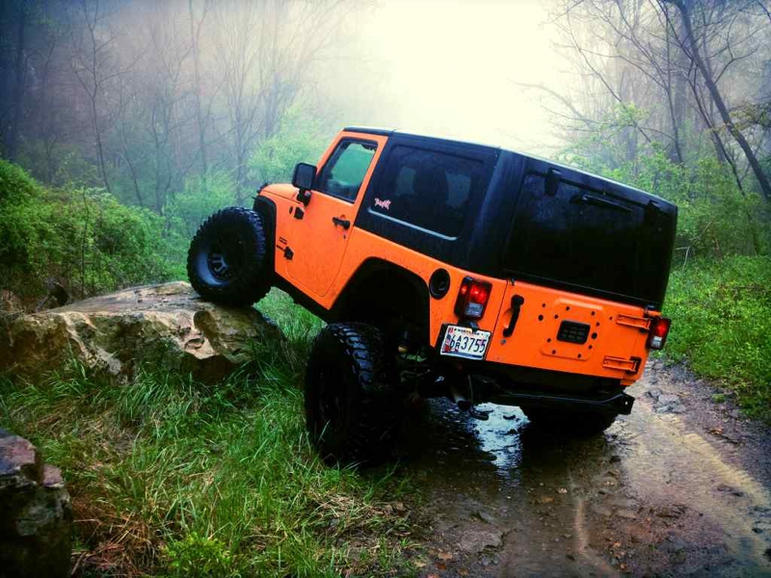

I have a Teraflex 2.5" bb and 35's and it does just fine for me, and i do a heck of a lot more than street, beach, and mild offroading.. IMO a budget boost would be perfect for your needs. Same ride as stock and fit up to 35's easily. Sure it doesn't flex like a long arm, but you get same flex as stock which does fine for me and fine for your mild offroad and beach driving.
As for "manning up with 35's and 18's, I wouldn't go over 17" and 35's but that's just my opinion. You'll get more sidewall for offroad and better performance aired down. I myself actually have 15's for that reason and also, 35" KM2's are $240 for 15" wheels, and $412 for 18's. Lol have fun with that!!
I would go 35's cuz you'll regret 33's. I went from 18-19.5 average mpg to 14.5-15.5 on 35's but still on 3.21's. That will change soon. Rock trac 4:1 case going in tomorrow and 4.10 gears soon to follow
