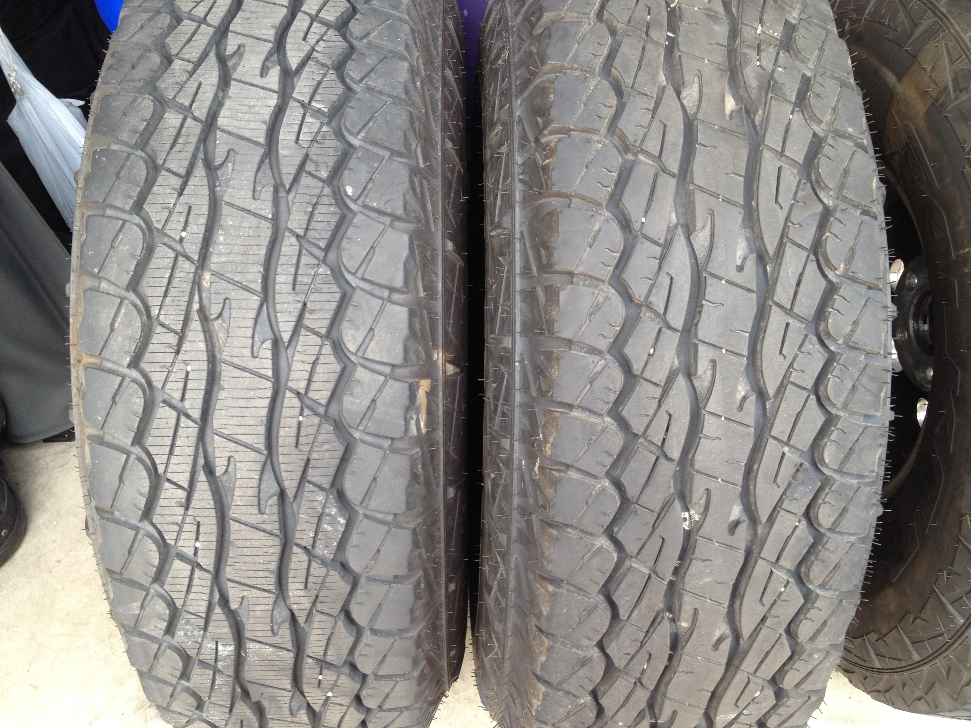

Didn't seem bad to me, very even and uniform, and plenty deep. They didn't cut the sides at all to keep them from chunking, just the middles. Seemed worth it for $8/tire.
Around 9k miles on the siped tire, maybe 200 on the new one.
Had Maxxis Bighorns before these, fairly aggressive mt tread. The Discount siping did help a bit on icy streets, but not a huge difference (more edges, but there just isn't as much tread block in contact with that type of tire). But again, it was worth $40 to get all five siped for that little bit extra traction.

Hey thanks for your input, much appreciated!
Yeah, Im not expecting a world of difference or snow tire like traction having the mt's siped. Just a little control on the hard pack is what I am after.
Yeah I agree, those sipes almost look factory like they are so straight and aligned. I think maybe it has something to do with the guy who is setting up and running the machine? A few pics I saw looked like it tore the tire up more than anything.

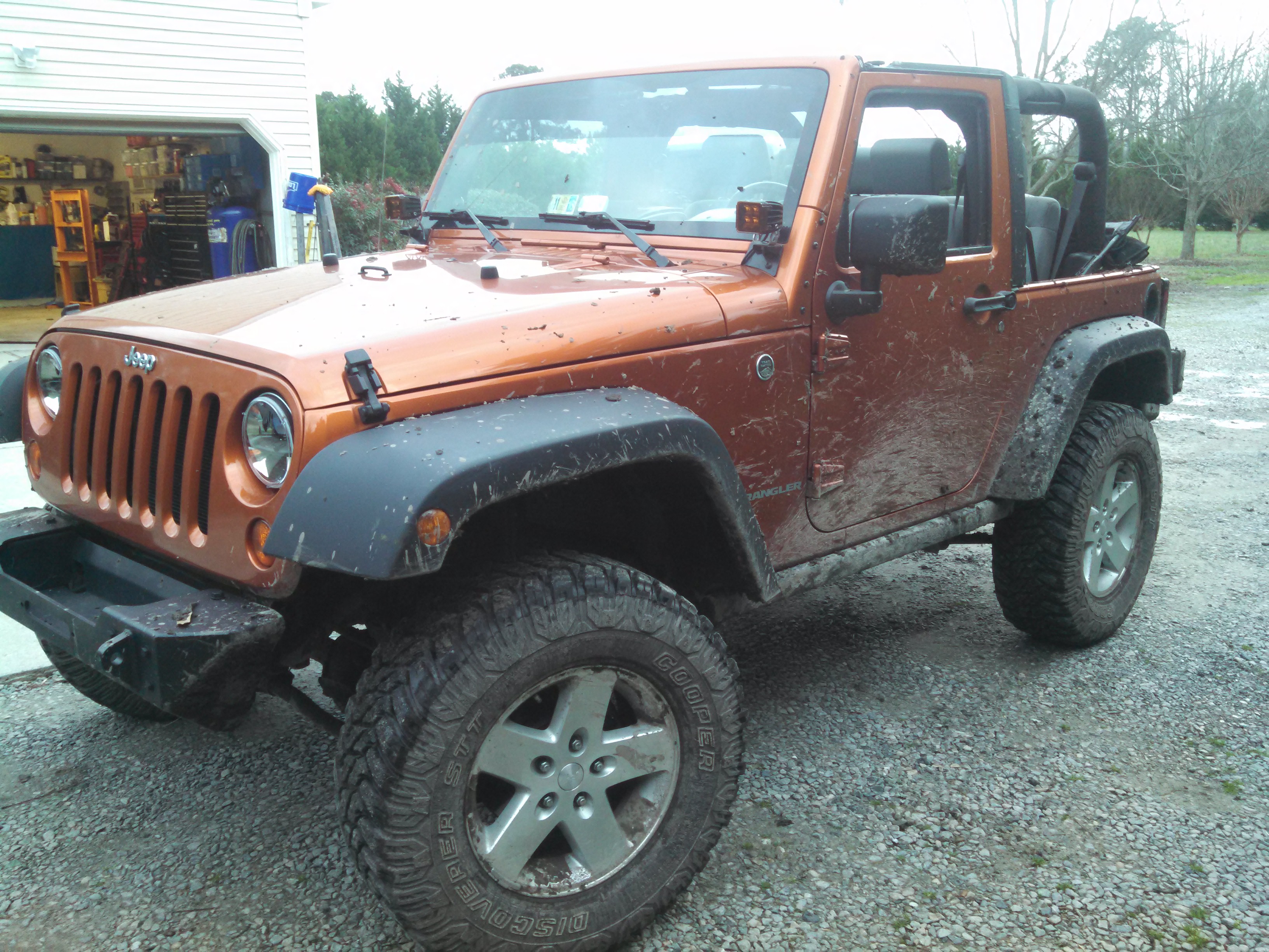

Stock wheels, STT's. It's a good combo and they ride well. I've had bad experiences with goodyears so I cannot recommend them unless someone is dead set on them.
These are 285/70-17 with the RK 2.5" stock mod.

nice, looks good
