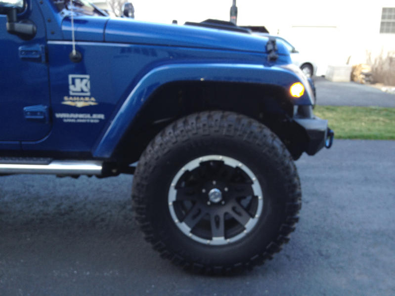

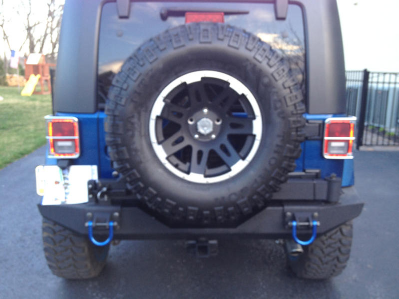

I have the RR 17x 9 Black with Machined lip rims. Just wrapped them with 315/70/17 MTZs. The look great and ride fine. My round trip commute is around 50 miles too.
Old Mar 18, 2012 | 05:42 PM
Offroad's Avatar
Joined: Mar 2008
Posts: 322
From: South Florida
You have to check the tire manufacturer specs for recommend rim width. It varies a lot between tire manufacturers.
Old Mar 19, 2012 | 03:26 PM
oriffx's Avatar
Posts: 374
From: Chester County, PA
Here's a couple of pics....

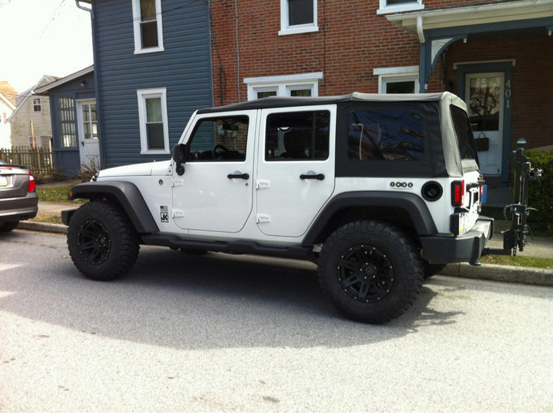

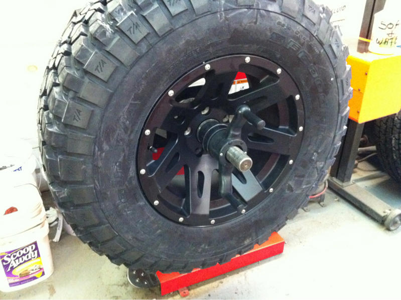

Have these rims in black satin. Mounted 285/75-17 BFG KM2s which measure about 33.5" tall when mounted. They fit great on stock 2012. Did need to remove air dam bc of slight rubbing. Could easily just trim a little off. It barely rubbed at full turn.
Have a TF leveling kit waiting to go on it but haven't had time yet. The tires do stuck out a bit past the fenders if that's an issue for you. Shouldn't have any rubbing issues unless I disconnect sway bars which I'm not planning to do without more mods.
Good luck with your decision.
