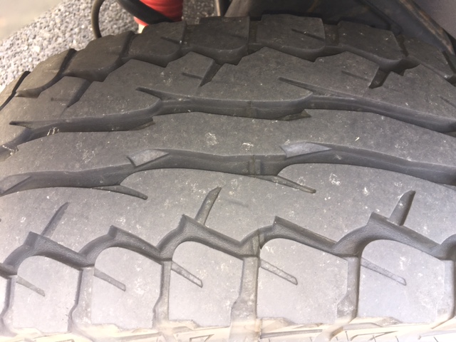

no pulling or vibration just light waving of the wheel, worse when rounding corner hitting a bump or down hill. front d/s seems the worst (1st pic)

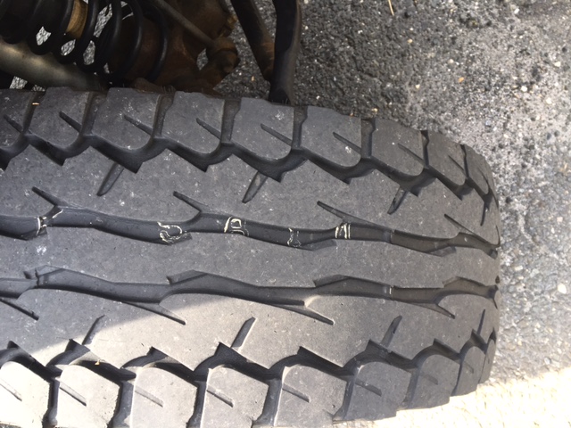

p/s front

I'm no expert, but I don't see really bad cupping in the photo. I do see that the left front is showing the most wear. This is to be expected for tires with 40K never rotated. Also, it looks like the (slight) cupping is mostly on the inside edge of the drivers front tire. Where every other lug is warn down more than the next. Is that correct? I would bet that the rear tires are not bad at all. Is that correct?
Also, you might think about using a little more air pressure, maybe 32-35 PSI. The center of the tire seems to have much less wear than the edges.
I think you might have a warn ball joint or tie rod end, maybe on the driver side?
What I would do:
1. Check the steering components for wear. Ball joints, tie rod ends, drag link ends? Also check that all the connecting arm and track bar bolts are tight.
2. Rotate the tires, putting the front left on as the spare.
3. Add a little air to the tires to move the wear pattern to the center of the tire. (also improves handling).
4. Get an alignment and make sure they print you a copy of the results so you can see what the changes were.
Finally, in the second photo, is that a nail/staple in the outer edge of the tire? Upper right side of the photo?
