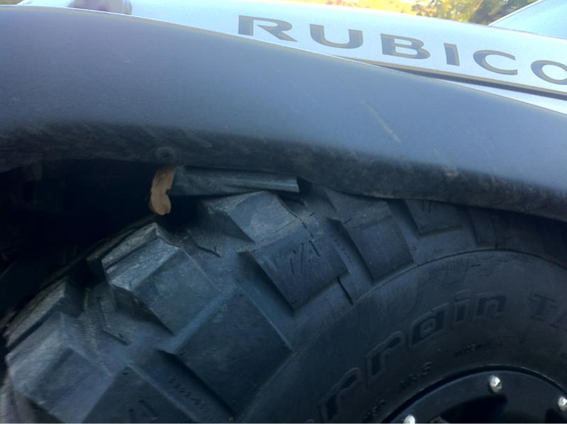

33s with flat flares would be perfect. Should prevent rubbing like I have when disconnected.
If it is a street queen you will be fine with a skinny 33. Watch the width or you could rub with stock wheels on the sway bar links.
