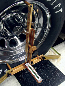

I've read that the spec is .15 degree, plus or minus .15 degree per wheel. I did a layout on a CAD system and it equalled to be .095" total toe in, measured at 18" forward of axle centerline.
This Caster/Camber/Toe Tool works great on the JK. It's made by Fastrax.
