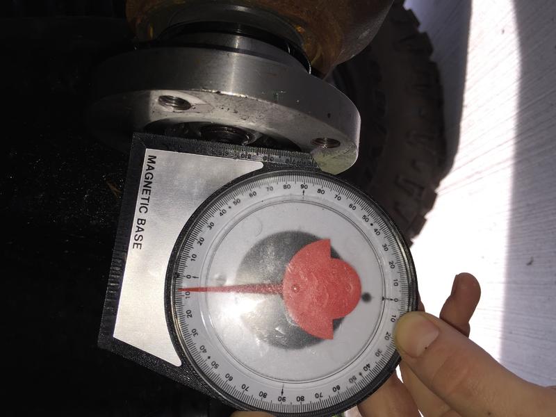

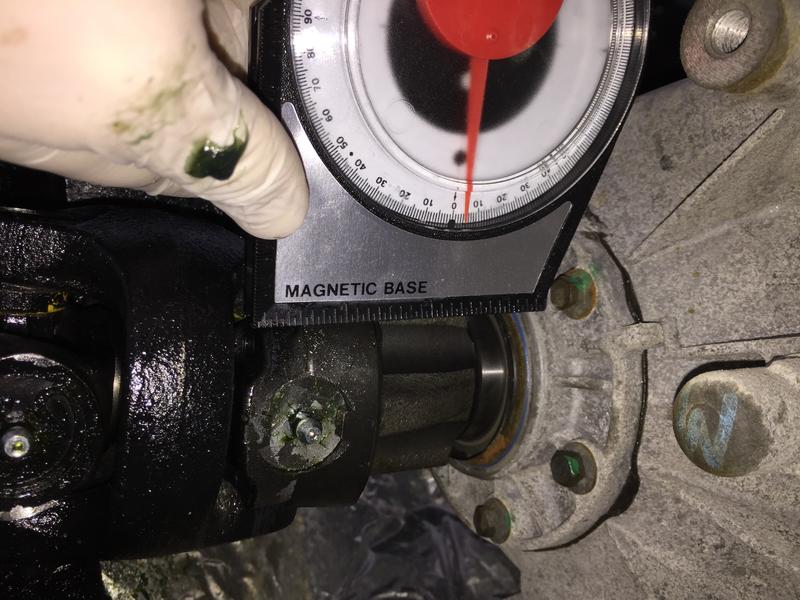

Old Dec 29, 2014 | 10:23 AM
  #30
going_commando's Avatar
Joined: Jul 2013
Posts: 47
From: Baltimore, Maryland
update, I took the rear DS off to get a more accurate measurement and found the rear is at 7 degrees as the Transfer case is at 8 1/2.(the close up pic of the angle finder is the TC) I then drove the Jeep and the slight vibration was not there. I re-checked both the pinion nut and TC nut torque and both are good.
My question for you is would 1 1/2 degree cause this slight vibration I am feeling from 25-35 mph only under acceleration?
It is a very slight vibration that only I can notice, Would Upper adj. CA be necessary to prevent future damage?
any help is appreciated.
