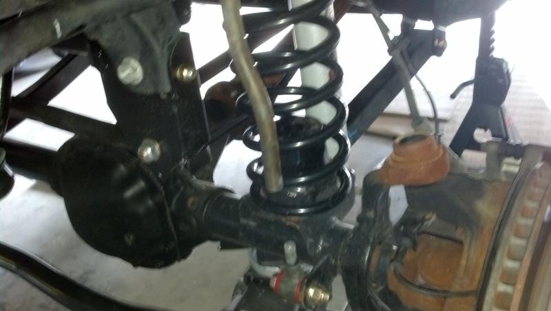

You say you have 4" size Rancho shocks. Do you mean you have the 331 in front and 332 in rear?
If your bump stops work for your tire size and shock travel now then I don't see what difference lowering your Jeep 1.5 inches will have on your bump stops other than to reduce your up-travel by 1.5 inches. Your existing bump stops are already protecting your shocks from over compression.
On the other hand, you will suffer from over extension. I'm not saying your shocks will be over extended. I'm saying your springs will be. Shorter springs with long travel shocks will make your springs pop out of their seats and make for a bad day. A number of companies make devices to keep your springs attached including clips that fit through the coils to chains that limit axle down travel. Either should work. Many recommend them anyway so your shocks aren't what's limiting down-travel.
One more thing... your stabilizer bar brackets might need to be modified too.
