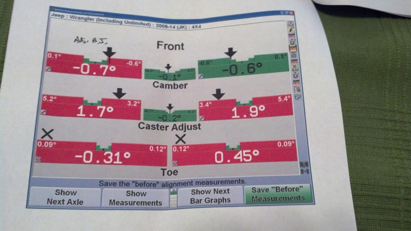

Just got alignment measurements. Shop said adjustable bj to correct camber, caster severely out and causing poor handling. To correct caster requires dealer cam adjustment kit. He said to take back to dealer and have them fix it, just had lift installed 4000 mi ago. Take back to them, another shop, or what?

They are talking cam bolts and you should avoid those at all costs on a jeep. A full set of adjustable control arms is really what you should be looking at. Your camber should be in spec and I would really question that. That means you have bent your inner C's on the axle. Is its more likely out of spec because the axle rotates as you lift it and correcting it with the control arms should bring it back closer to factory spec.

1. Dealership installed a kit without alignment......I would hammer their asses, if you chose not to get it aligned, well now you know.
2. Make them correct the issues if they suggested and sold you the lift. If you bought the lift and took it to them then you will need to source the correct parts for the fix.
Please read Dirtman's posts. Do not allow them to install Cam Bolts. This is fixed with adjustable CAs.

Thanks guys, will see dealer about camber being off. Hopefully nothing wrong with C but to correct that go with adjustable BJ? and if so go ahead and do left and right? As far as caster, on my own pick up some adjustable CA, and keep the dealer out of that. Any suggestions? I know opinions will very, I'll prob order some soon.

I wouldn't worry about the camber.
The caster for sure should be addressed with some adjustable arms.
