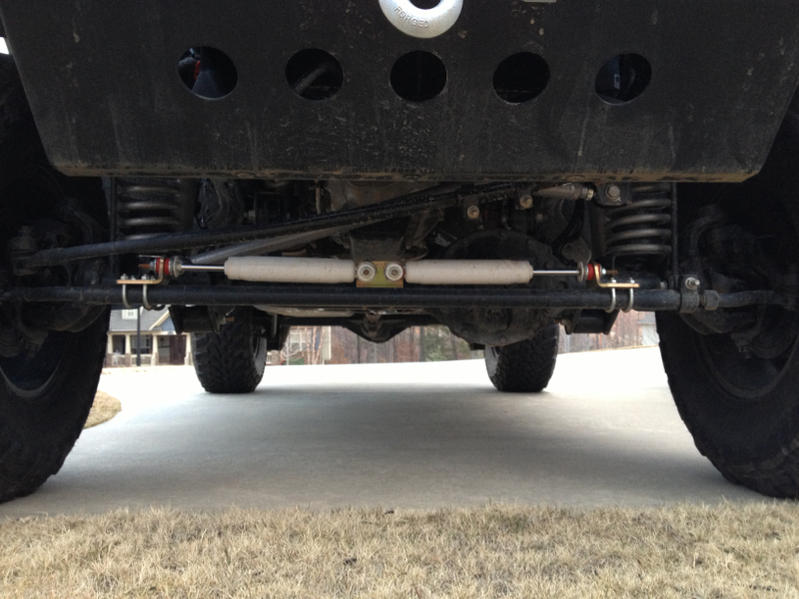

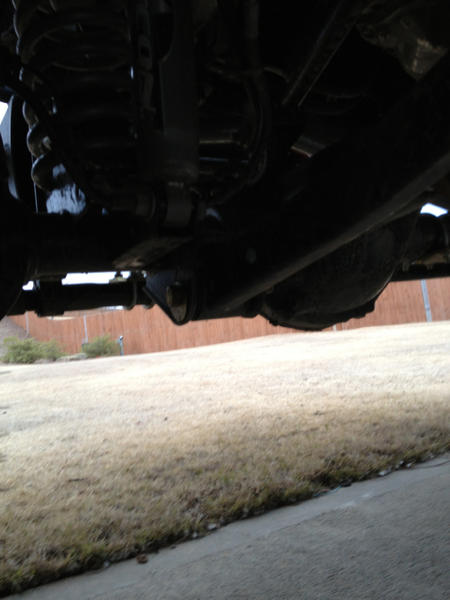

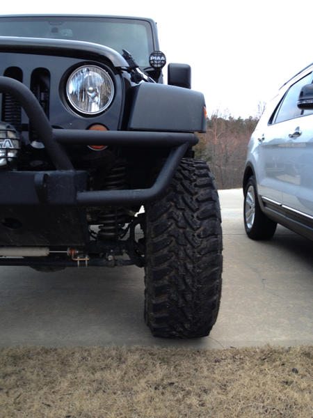

I checked the jeep out this morning before work. The cam bolts are in and it doesn't look like it has moved. There is a slight negative camber but I read online that is what you want, about 5%, Seems like a lot. I didn't check the %. I also read that a toe out can cause this wandering. Is that true? Apparently a lifted jeep should have about 1/8" of toe in. I am going to check that tonight. If toe out is the problem that should an easy fix. You would think an off road shop would know this.

What is your caster? I am at about 5 - 5.5 with a 2.5 inch lift and the AEV brackets (which added the positive caster).
I have play in my steering wheel as well but only like an inch or so. 6 inches is ridiculous...sounds like something is not tight.
