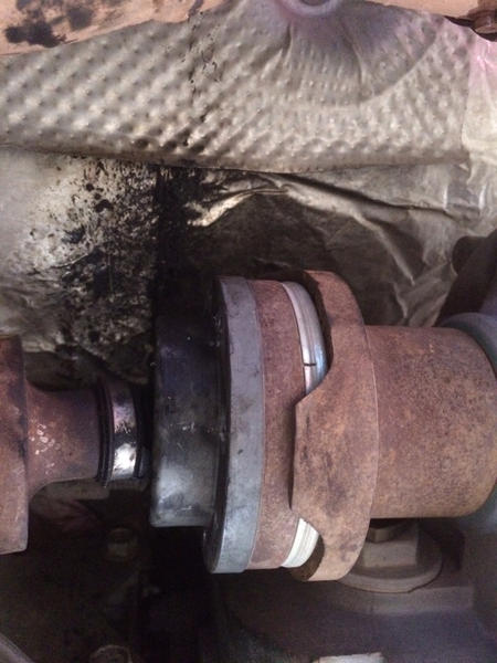

Check the rzeppa joint on the front driveshaft where it bolts up to the transfer case. At 3.5" of lift you've likely worn it out. The tell-tale sign is grease spit and slung on the underside of the jeep tub directly above this joint.
Issue on the 2009 is when you have an auto and disconnect at about 3"+ the driveshaft can rub on the tranny pan and the rzeppa can't handle the angles and the boot fails. Looks like this:

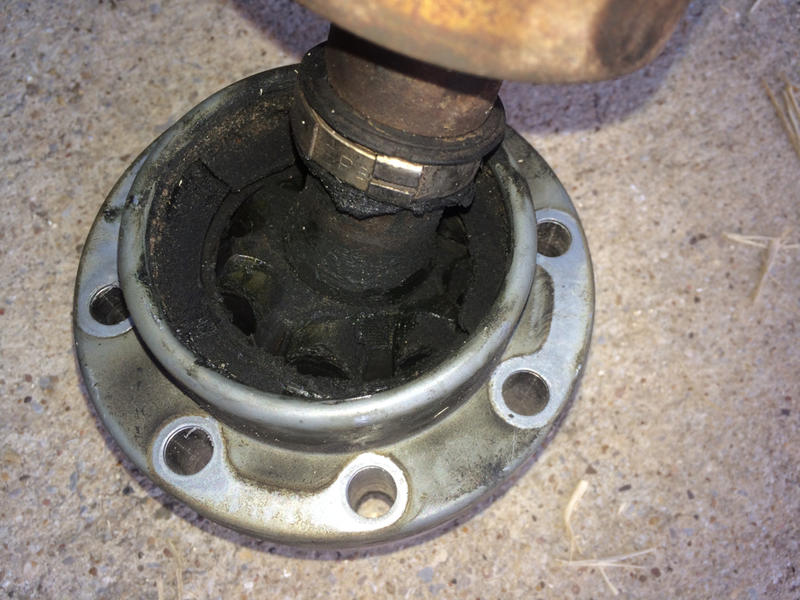

Looks fairly normal except for the grease. When I took it off, looks like this!!!!
