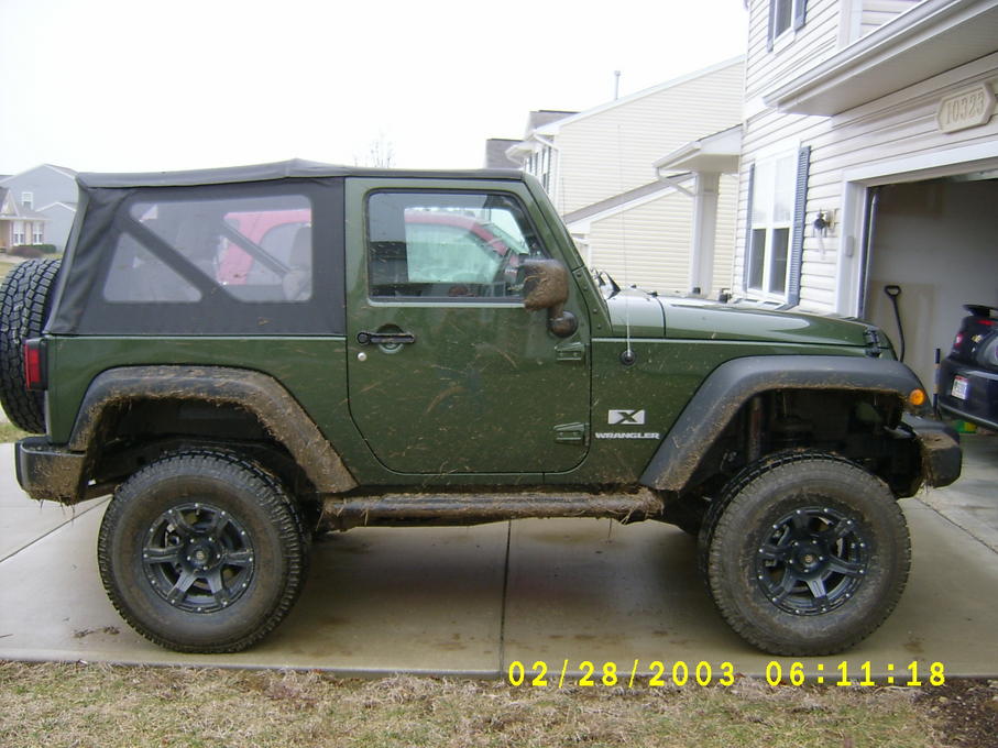

Okay, so not 6 months ago I was pondering all your questions. What I went with was a 4" Rough Country lift and 33" tires and ATX Predator rims. I would definitely recommend taking a look at the American Racing ATX series stuff, the wheels I got are teflon coated and look amazing on my Jeep Green!
I still have plenty of room to move up to 35" if I want. I didn't plan on doing any serious off roading either, just wanted it to look cool. With the 4" I have plenty of room. I went with Toyo Open Country AT tires as they handle off-road and provide a nice stable, smooth on road ride (at least I like them).
A couple of points though that I found out through experience (if you can call it that) is that once the lift is on, the Jeep with drive much different, you may not like it...however, in order to get it right where you want it, there are several additions you can make to get there that aren't terribly more expensive. Just want you to be aware since I learned the hard way. One, I got the RC dual steering stabilizer and it definitely helps with some of the bounciness and flightiness. I have a set of upper front adjustable control arms on the way, these are supposed to help adjust my caster angle since once the lift is on, that setting gets thrown way out of whack.
In addition, my spedometer is off and am going to purchase a programmer as soon as the tax refund comes in for $130 or something like that. This will allow me to set my new tire size and correct some of the spedo being off. Plus, I will be able to precisely set the steering to center (as I don't think the tire shop did it very well) and turn on my daytime running lights...
I have a 6-speed and the 3.21 gears that comes with the X, when I got the 33" tires on, I lost 6th and just cannot accelerate like I want to. I am now considering re-gearing, but need to wait until I've got the funds, I've heard it runs anywhere from $1200 to $2000 to do this? It is almost a necessity at this point for me though, as I want to zip around like I'm in a sports car...lol
So, the basics, once you start you won't ever want to stop...I would recommend the Toyo ATs, the ATX wheels and taking a look at other options, steering stabilizer, control arms, etc. Although none of this may be "necessary" it is something to consider.
