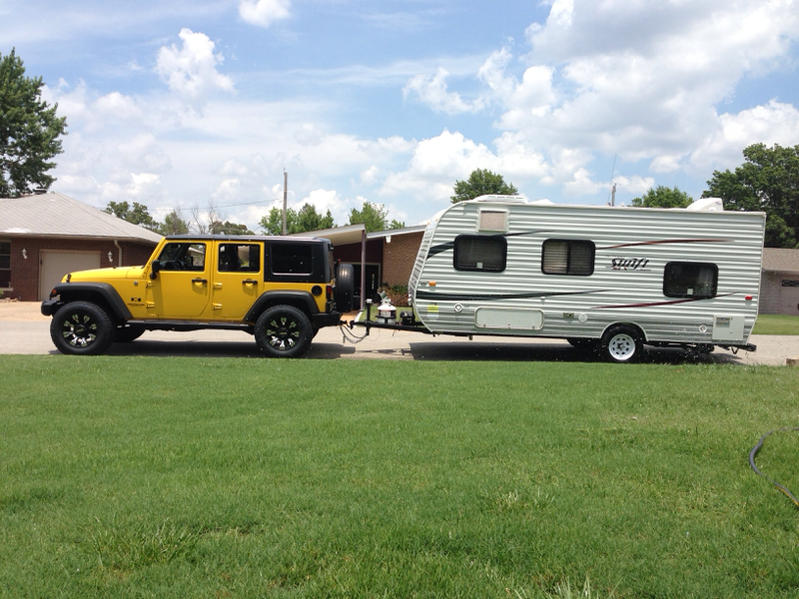

I have an '08 and tow a 20 camper. I run 35 on mine and I have the 373 gear ratio. I put electric brakes on mine.I would suggest putting a dedicated transmission cooler . I have no problems unless its a steep grade
