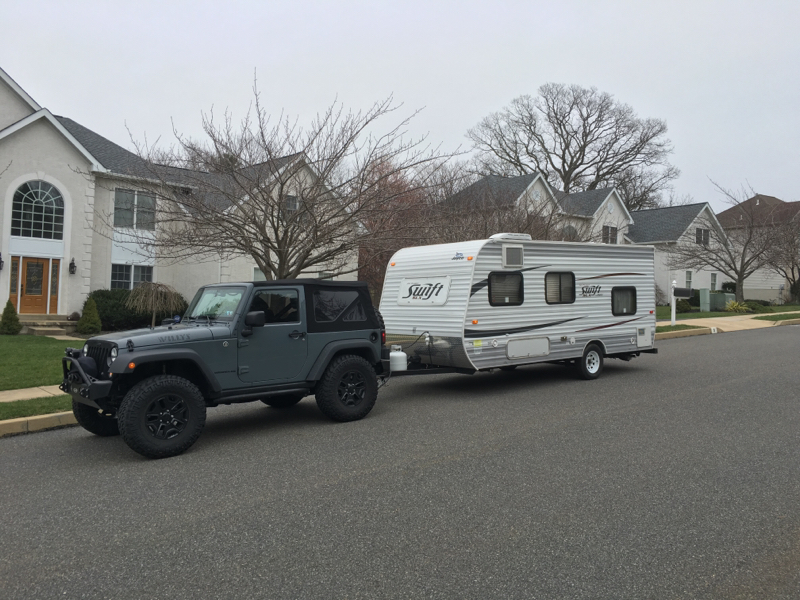

I wouldn't want to tow regularly but just used the two door to tow my 2500lb camper and it worked well.
