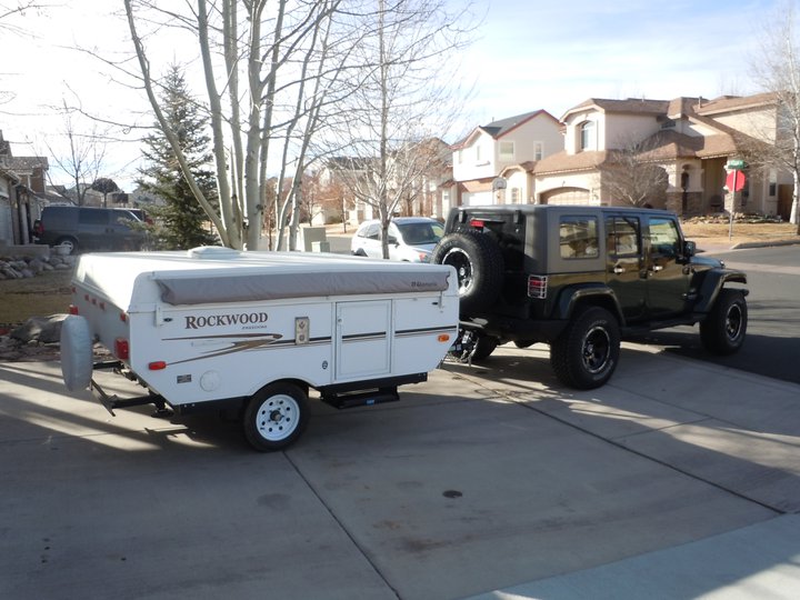

I have a 4dr rubicon with 35's and 4.10 gears. I tow a 19 ft camping trailer in the summer. The weight of the trailer is nearly at the max towing capacity of 3500lbs. I live in CO and have towed up some pretty steep highways to reach my destination. It has done pretty well in this situation. I can tell you that on the highways were the speed limit is 75... I have struggled at times to keep it above 45 on hills. I am nearly ready to re-gear to 5.38's which will help dramatically.
I think with what you want to tow you will be just fine with your current set up- I would be surprised if you will be towing 2000lbs. Good luck
