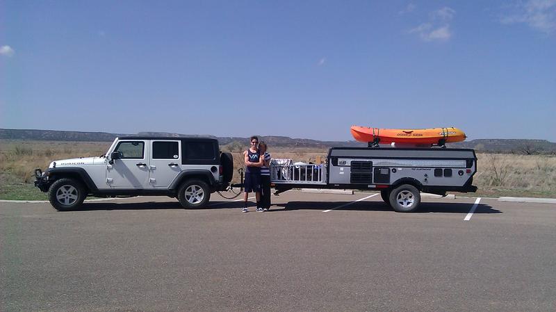

You can tow much more than 3.5k. Many of use do so on a regular basis. There is no real reason for the low tow rating. The same JK all over the world is rated to pull different wts. In Germany it's 7K lbs with trailer brakes, in Australia it's about 5k lbs, etc.
ID:	543110   Click image for larger version
