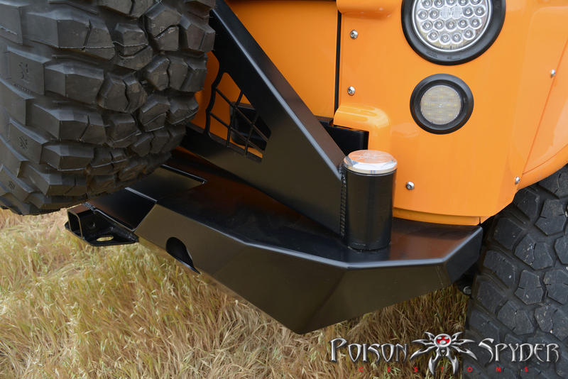

The bumper and the trusses for the receiver are brake-formed 3/16" plate steel. I am not a welder but looks like mig and a roll of dimes on all connection points. Is that enough info to make an assessment?

The bumper and the trusses for the receiver are 3/16" brake formed steel. I am not a welder but looks like mig and a roll of dimes on all connection points. Is that enough?
For the square tube the ball mount slides into, 3/16" works for light duty towing. That part should be fine. Welding that to a flat piece of 3/16" steel is not going to get it though. If there is some internal support in that area on the inside, that helps. And there should at least be some gussets on the outside. Ideally, you'd weld the square tube to 1/4" plate. Again, without actually looking at the bumper, the info I have tells me that it is a weak design for towing much over 1000lbs.
The second concern would be the welds themselves. I know there have been non-structural weld failures on PSC products (and other manufacturers - not knocking them, just saying it has happened). There is not a ton of weld surface there, so the welds need to be good. Looking good and being good are very different. Grab a Reese ball mount and look at the welds on it. They don't look all that pretty, but they are very strong (flux-core). Most of the general fab welding they do isn't critical. There is a ton of weld surface. If the welder is good and know what he is doing, he will make the needed adjustments to lay strong welds. I'd say it is pretty tough to get total fusion on a structural weld that is on 3/16". It's a touch balance between cold lapping, under-cutting, and burning through.
Just saw the picture. The outside looks gusseted appropriately. Ideally, there is some internal support on the inside of the bumper as 3/16" would be flexy, flexy.
