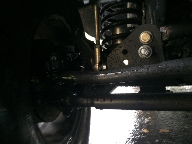

Okay. Can the bolting on ground cause stearing issues? The track bar is bolted to the artec truss. Shocks are fox for lift. Few pics. I don't know if tb mount is in stock location or not. The empty bolt is for my fix ATS.

From the above picture, it looks like your draglink is lower than your TB at the Axle/knuckle side. You want the draglink and TB to be as parallel as possible to fix the bump steer. You may require a trackbar flip to fix it. I have the artec truss, synergy TB bracket and DL flip kit installed on mine and i also have the RK 2.5 X-Factor. No clearance issues at full flex with 33" tires.

That is a raised trackbar bracket in the pic, correct? As noted, raising the axle end of the trackbar without also flipping the axle end of the draglink (up on top of the knuckle) is the cause of your new bumpsteer. Draglink flips generally require a minimum of 3" extended bumpstops to keep the draglink from contacting the frame.
Do some measuring to see if you can make it work, or consider removing the bracket...

Thanks for all the info. The track bar bracket is part of the artec truss system and it has 3 mounting locations. It is welded in as part of the truss. Let me get some better pics up this evening or tommorow to help with u guys seeing stearing angles and the bracker. I think there be a bit of an optical issues ion from my pic.
