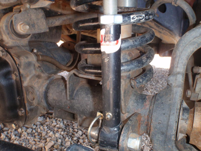

Your coil is coming unseated also. You need to rotate it clockwise.
Yep, great catch. Ill be doing that as well. Whats the easiest way to rotate them. Jack the jeep up to get the weight off of it and then rotate.
Thanks for spoting that one spring, upon closer inspection of the other springs i found this........I guess i found some projects for me today.
Old May 6, 2011 | 09:53 AM
rinkishJK's Avatar
Joined: Jul 2009
Posts: 4,038
From: NORTH JERSEY
Originally Posted by saravonshep
Attachment 157869
wow! i bet your truck has a lean from that!!! u need spring retainers for the front. rock krawler makes em, or u can make your own cheaply!

Old May 6, 2011 | 01:16 PM
saravonshep's Avatar
Posts: 1,235
From: Spring, TX
Originally Posted by GON WHLN
Rock Krawler makes a simple fix for your front springs coming unseated.
Spring clips. cheap and easy.
Ill look into these, could be a cheap fix for now.
