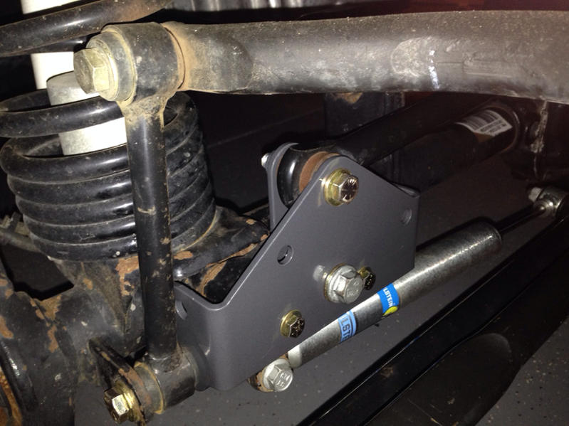

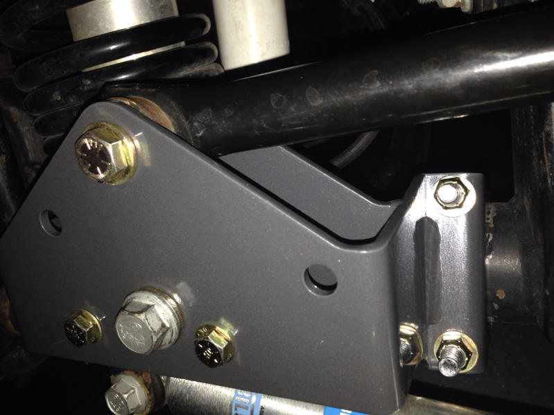

I picked one of these up from synergy, steers like a sports car now.....well almost...
Next on my list!
