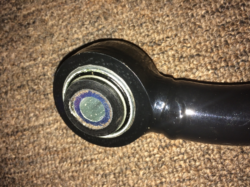

Superlift sent me their new TB with the new Dual durometer joints. A little hesitant to install because i was running Synergy's. Good thing i did because the Heim joint used in the Synergy bar was already loose. I immediately felt the difference on road over bumps. Not sure if it was the worn bushing or the new DD bushings used in the SL bar. Anyways ... Can't beat the $119 shipped price.

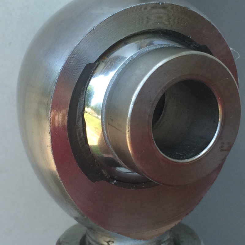

Its just the type heim thats used.
I just bought a FK heim to replace it.

Old vs new
